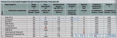

JetGroove Posted April 6, 2012 Share Posted April 6, 2012 холивар..http://www.zr.ru/articles/51592/на http://www.lagunaclub.ru/forum/showthread.php?t=30559 Link to comment Share on other sites More sharing options...
