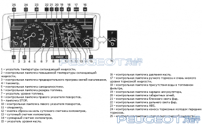

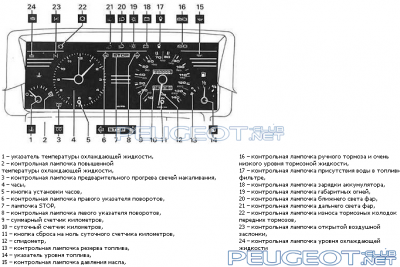

Arthur_King Posted September 24, 2013 Share Posted September 24, 2013 Brake-это Пежо болит... 1 Link to comment Share on other sites More sharing options...
