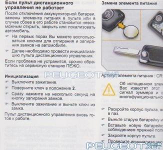

x7g6007 Posted January 8, 2013 Share Posted January 8, 2013 как переобучить ключ после замены батарейки? Link to comment Share on other sites More sharing options...
dimon405 Posted January 8, 2013 Share Posted January 8, 2013 Держать любую кнопку и включить зажигание. 1 Link to comment Share on other sites More sharing options...
x7g6007 Posted January 9, 2013 Author Share Posted January 9, 2013 держал не получилось.комп пошет remote control battery low Link to comment Share on other sites More sharing options...
dimon405 Posted January 9, 2013 Share Posted January 9, 2013 Это значит что батарейка разряжена. 1 Link to comment Share on other sites More sharing options...
x7g6007 Posted January 9, 2013 Author Share Posted January 9, 2013 батарейка новая Link to comment Share on other sites More sharing options...
dimon405 Posted January 9, 2013 Share Posted January 9, 2013 Значит ты ее закоротил пока менял или они бракованная. Link to comment Share on other sites More sharing options...

Maks071RUS Posted January 9, 2013 Share Posted January 9, 2013 remote control battery low -разряжена ... 1 Link to comment Share on other sites More sharing options...
x7g6007 Posted January 10, 2013 Author Share Posted January 10, 2013 всем спасибо всё работает!!! а батарейка которую я заменил видимо дефектная так как при замере напряжение с 3v резко падает до 2v Link to comment Share on other sites More sharing options...
